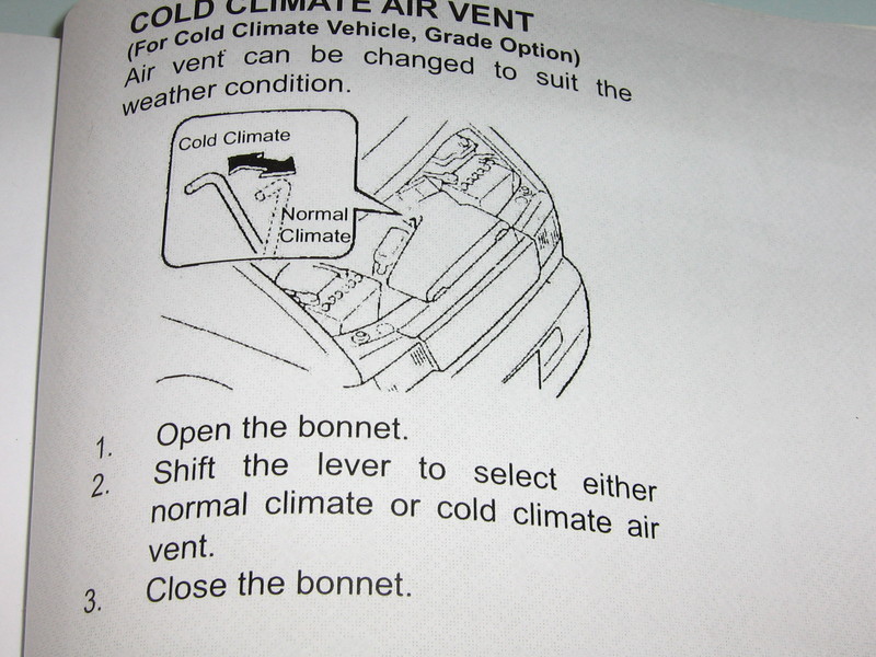

Hi picked up my freda yesterday and have a couple questions. Poking around under the bonnet I noticed a small lever on what looks like the airbox it has 2 positions the label is in Japanese surprise surprise! Wondered what it does?

Yup the lever takes air from the front for Summer or the rear of the bonnet in Winter;
