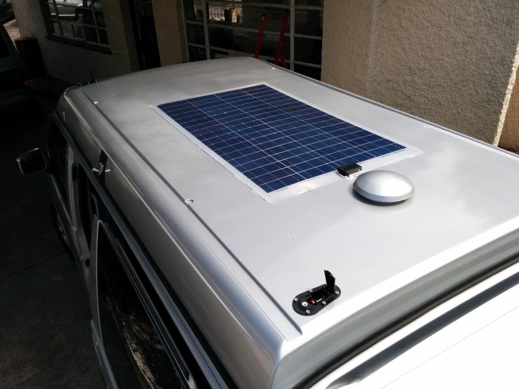

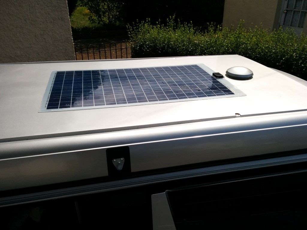

Did a very enjoyable installation today for a lady called Jen with a mushroom roof that opens WAY up, almost vertical, pushed up with a metal bar with a hoop in it, and then a board inside flips over to fully open the tent. Huge inside. The roof locks down with keys. Really good roof. I forgot to take pics with it open :-(

Looks like a JAL conversion.

How does the panel perform when the roof is up if it tilts to near vertical?

The angle still means it point pretty much at the sun in the perpendicular. I got 4.5 amps in partially cloudy weather yesterday with the roof up but without the vehicle aligned optimally. You can be off axis quite a bit with not much consequence.
Sgt elvis. I use this panel ( indeed the same as the vw one) as there are no existing mounting holes and I'd need to drill two 8mm holes through the roof to bolt a regular panel on. It's not a problem. I bolted one on another aftermarket roof recently, but most people don't want that. That roof was heavily ridged and warped so bolting a panel on made more sense.
