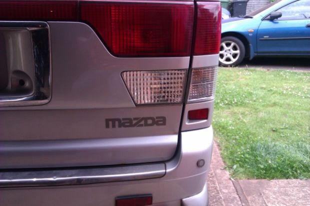

Re: Help Needed
Am trying to remove to enable me to drill a hole in back, put in a white LED (on the white reflector) lol and then wire it to the reversing lights. Same with the red reflector wired to the brake lights. Think i should be able to run the wires up through the rear door into van and down through the trim inside. If it works......
Marc

I take it you mean this...Marcadia123 wrote:Am trying to remove to enable me to drill a hole in back, put in a white LED (on the white reflector) lol and then wire it to the reversing lights. Same with the red reflector wired to the brake lights. Think i should be able to run the wires up through the rear door into van and down through the trim inside. If it works......
I very recently considered just what you're thinking of but I couldn't determine if the reflector under the clear cover was curved to the rear surface, which would be good, or else flat and thus not so good.
In the end, and partly because I wanted the reversing lights to double up as 'loading lights' for night time, I fitted the following into the usual revering light sockets
http://www.ebay.co.uk/itm/281345995324? ... 1497.l2649
It took about 1 1/2 hours to fit both - you have to put a half round file into the bulb hole so the bulbs go in - you take off only a very small amount, not enough so you can see.
You'll then find they fit very well, the base fitting snug into the original bulb holder.
A connector on the back of the bulb, mountain bike inner tube zip tied over the connector and bulb base for waterproofing and more zip ties to fasten the bulb in place and there you go.
The lights are truly fantastic - almost too bright. They draw 0.51 amps each, a lot for LEDs
Do this and you'll have an excellent view when reversing.
I added a little switch which turns them from being powered by the starter battery when reversing to the leisure battery when loading or just sitting out of the back.
If you do convert the reflectors to lights, please let me know how you get on

Re: Help Needed
Perhaps you have a facelift panel fitted as this is what fitted from 1995 - 1999. The reflector strip changed from amber to clear around 1997/8.Marcadia123 wrote:..as to the tailgate I have a 96' so no grab handles but will take your advice on board
