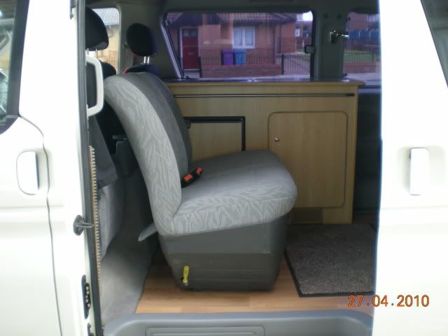

Hi don't know what part of the country your from as you have not put it on your on your avatar, here is a photo of my previous bongo I had a mini side kitchen comprising of 2 ring hob sink,fridge and PMS with a leisure battery, I kept the rear seat but replaced the middle row with a two bum lift up VW seat that I got of eBay. the company who carried out the work were " Elite Camper Conversions " they are in Worksop notts

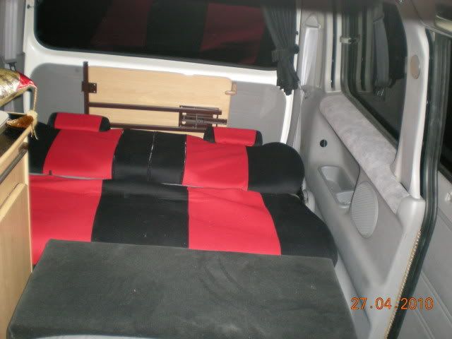

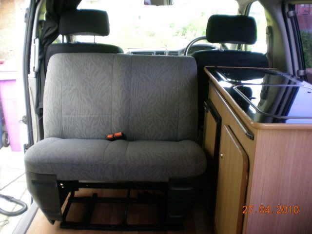

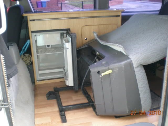

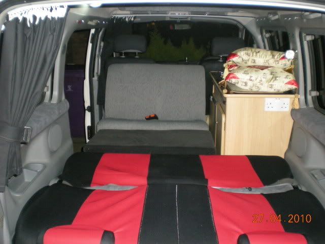

Hers my low budget conversion that still sleeps 2 or seats 8
Kitchen
Mine is mainly a people ca=rrier but its nice to be able to do a little cooking too

winchman wrote:Hers my low budget conversion that still sleeps 2 or seats 8
Kitchen
