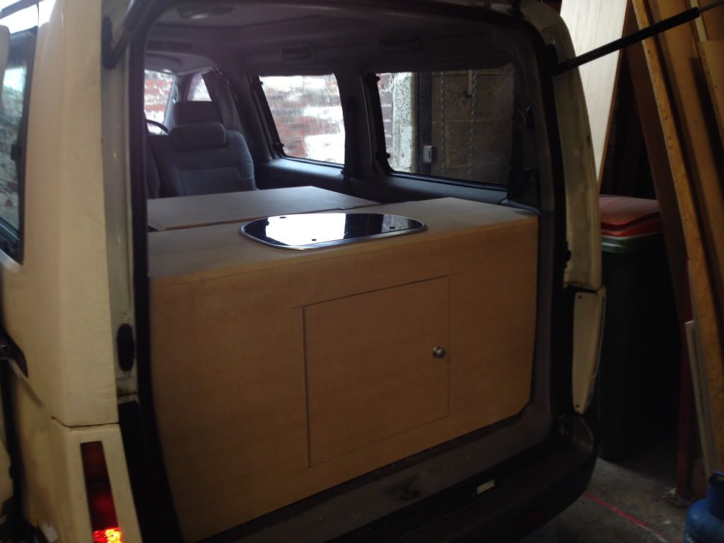

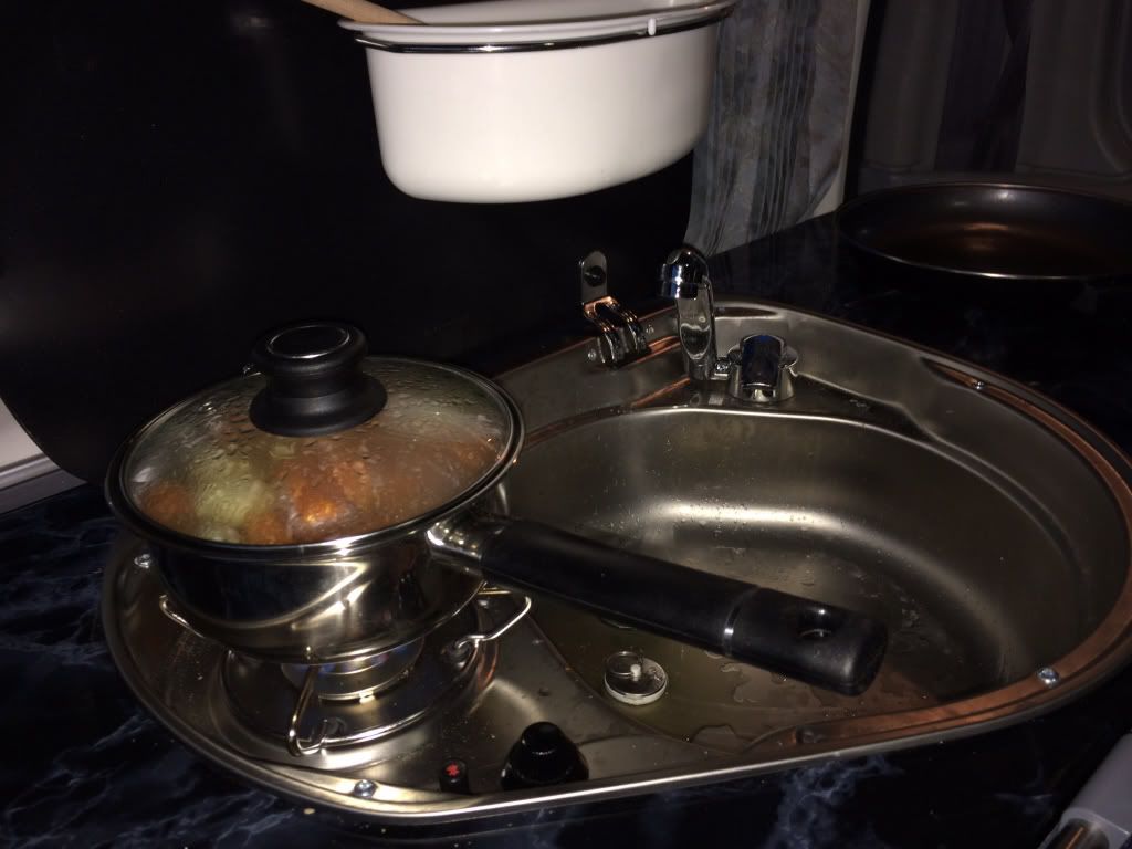

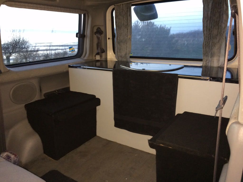

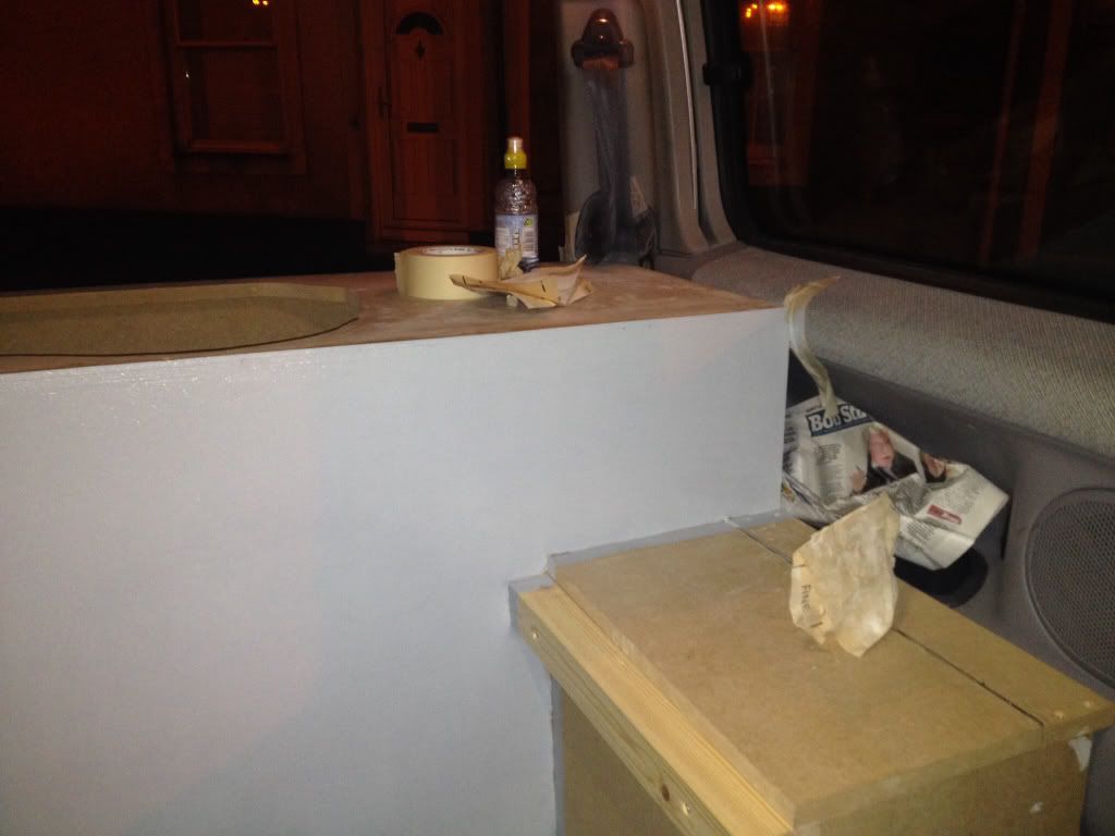

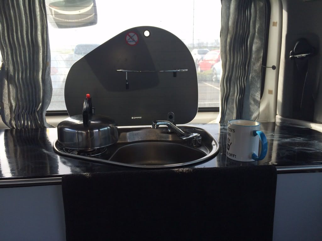

Hi guys, thought I would finally get some pics up of my DIY rear conversion. All units are made from 18mm MDF, the tabletop and work surface has been covered with DC Fix marble effect viynl, units painted in dove grey bathroom paint and seat boxes covered with acoustic carpet. I also fitted a smev 8821 sink and single hob. There's a cupboard in the back that allows me to get access to gas bottle, 2 10 litre jerry cans (Clean and waste) and enough room for a couple of pillows, camping chairs and a Cobb BBQ :)
In the seat boxes there is enough room for all kinds of pots, pans, mugs, kettle, toaster, utensils and food.
The woodwork was mostly done by my father in law over 2 Saturdays and it took a week to paint, viynl, carpet and get all the wiring done.
