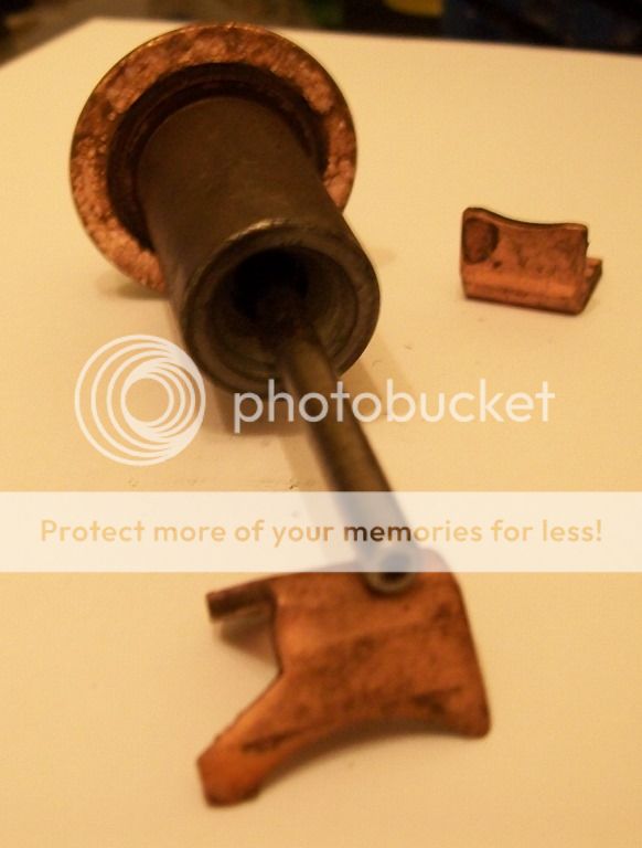

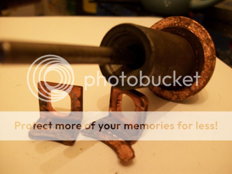

Very big thank you to Ady [Northern Bongolow] for sorting me out today, only had the motor just short of 3 years and was never told there was another access point to the engine under the drivers seat :oops:
Anyway Ady went to work on it cursing a bit at times as the bolts were a tad tight :lol: just over a hour later, all sorted and firing up like a good`un,
Brilliant job matey, well chuffed as id never of managed that im sure, great to meet up with you and your family, pictures of worn parts photographed as promised =D>

Post by aintgotabongo » Mon Feb 17, 2014 12:40 am
Tother end

Worn parts looked exactly as the pics above and no need to wire brush the plunger as in the kit bought from ebay, you get a new plunger.
