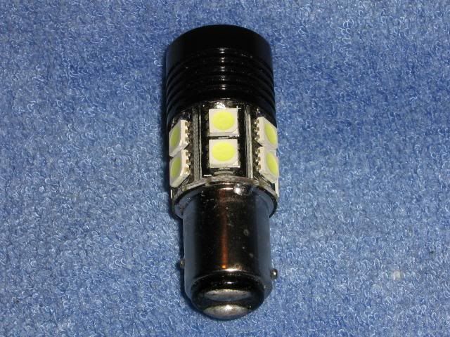

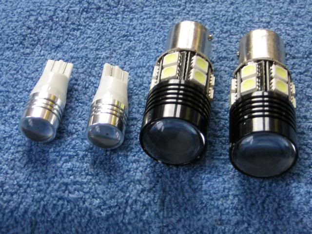

I have tried a few LED with limited success ..
I had no luck at all with the high power Cree variety ..
The small cree wedge 501 side lights got seriously hot .. then went into a flashing mode ..
So I fitted normal 64 SMD bulbs in the front side lights .. these are fine ..
The Cree / SMD stop / tail bulbs .. although the same off set pins as the Bongo .. the bottom lecky contacts would not line up with those in the bulb holder .. so I had to re fit the old twin filament stop tail ..
