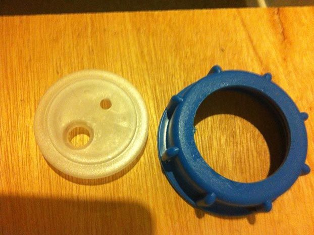

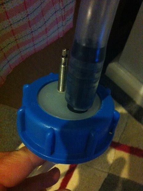

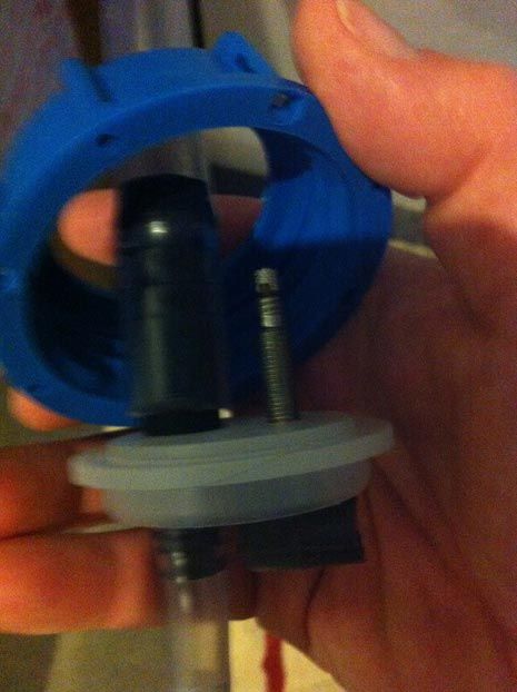

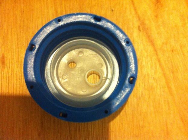

done and dusted. Tap mounted on side of my homemade unit. Also I sourced from very helpful supplier a special top for the water container designed for a leccy pump with two holes, larger for water pipe, smaller for leccy cable. I pushed a reducer into the water hole, allowing me to connect tap hose to top and bits from a homebrew kit to the inner side. In the small hole I have screwed in a cycle inner tube valve (sterilised) to let the air in but not the water out :) I still have the original top so can easily unscrew the tap conversion top and use the original top for carrying the container to fill it up.

I got it from C.A.K. Tanks, Warwickshire in person. Can't find it in their catalogue or on their web site! Probably explains why it took them a very very long time and much speaking to bosses to come up with a price. They did say it was standard kit but obviously not out of the Argos Xmas catalogue!!! That's not very helpful of me .... Pic laters
