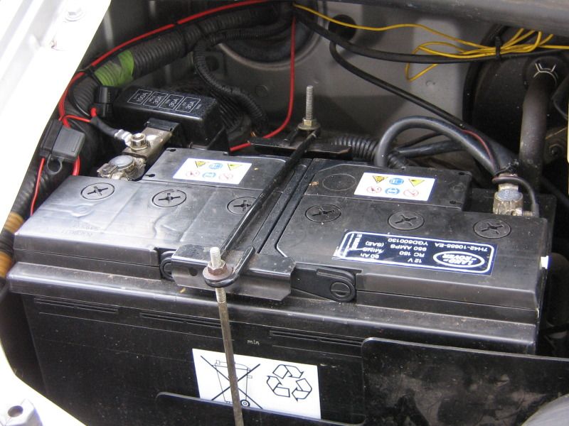

I have standard Mazda battery trays for both the starter battery and the leisure battery ...
I fitted rubber inside the 'lip' and both batteries fit 'on' rather than 'in' the battery trays .. but being a 'snug fit' and well clamped .. I don't think they will go very far ..!!
95AH starter battery ..
110AH Leisure battery ..
110AH battery No2 fitted .. and under bonnet wires tidied up..
