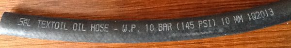

Just had the same problem.
Replaced both pipes from gearbox to radiator bottom with 10 bar high temp hydraulic rubber pipe from a local supplier.
Just done 2000 miles no leaks or problems
Far easier to thread and clipped to existing pipes for security.
