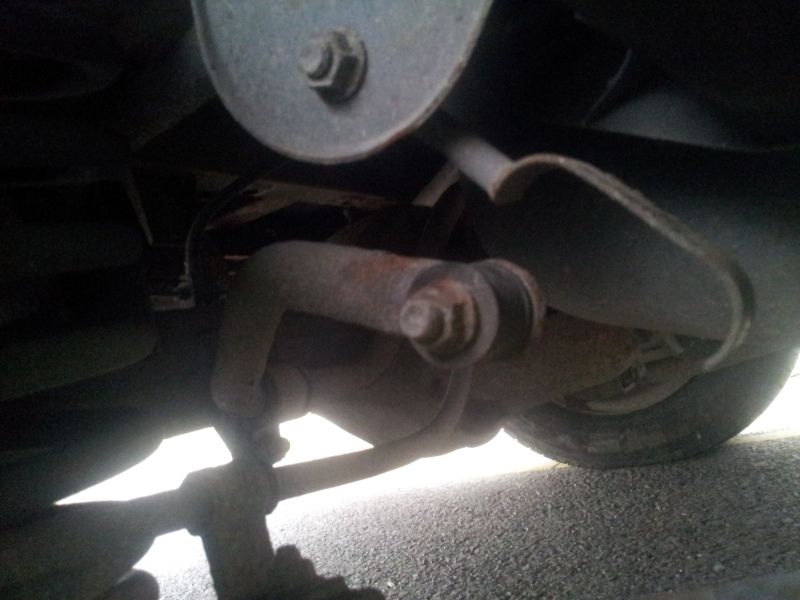

Post by stefan442 » Wed Mar 06, 2013 6:09 pm
Was down on the MOT as loose! I really should have looked before! But at least you don't have to pay till it passes. I assume I can change this just by jacking up and wazzing it off and putting le replacement on!

Definitely broken! easy to change the only problem I had was the bolts rusted and being a fine pitched thread ended up shearing two out of the four bolts #-o or maybe I'm just too heavy handed! also helps if you have a decent 14mm hexagon socket if they are tight less likely to round of the nut & bolt heads.

I just cut mine off and replaced with new bolts

if they go like this it is usual that there is slack in the bushes to the chassis or the rear axle bump/s stops are missing.
may be best to do the chassis bushes anyway, all new together then.
