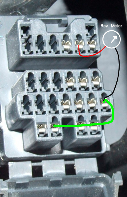

Ah Ha, just had exactly the same happen! Belts changed last week and the first long run found the engine causing vibration as we paused at junctions and roundabouts, but not consistently.. Suspecting the idle controls as well, there is an ISC solenoid at the back offside of the engine, but just about to go and look at the manual to see what the adjustments are before going to talk with the garage. There doesn't seem to be any mis-firing merely judder and shaking at low rev's when idling also the idle rev's seem to change between pauses but consistent when just sat stationery.
Re: Cat Heat Sensor and lumpy idle (V6 1997)
OK well the Air Adjustment Screw which sets the idle speed is shown below reached from the drivers side, but you need to put the ECU into Test mode to feel the change I found, Earth the TEN connection and if you have a Rev. meter then use it as well with NO loads A/C off, Lights off etc. then 680-720RPM
I found a single turn, anti-clockwise, increased it sufficiently.
