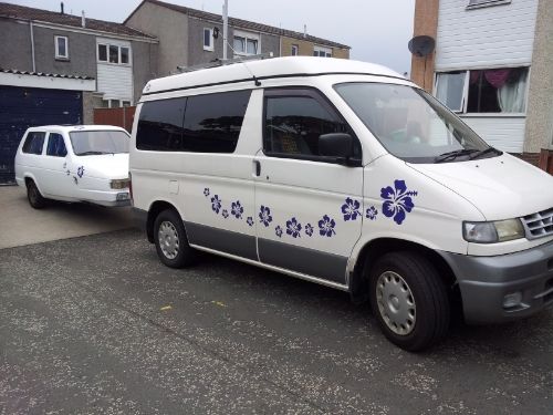

Well I started my little Reliant project in January and we have just had our first outing with it this weekend at Belladrum Tartan Heart Festival (a round trip of about 300 miles). We have a Ford freda which is a four berth but I have a family of five so we needed an extra berth for my eldest as he always complains about being made to sleep in the awning :oops:
At first I toyed with the Idea of building a tear drop but I am unconvinced of my carpentry skills so got thinking about the alternatives. I have always wanted a Reliant and because of their light weight and compactness I started searching. I could only find Sheila's Wheels and one other picture of a camper van conversion online so wasn't too sure of the viability of this idea. Well I bought a broken Robin on 31st January and trailered it home, put it in the garden then set about with the dismantling. I posted my plan on the Reliant forum and got a couple of PM's almost immediately one from a chap who wanted the engine and another from someone local who had already done a trailer from a Rialto. I wanted my Robin to look like a Robin and when I went to see the Rialto I was pleased to see he had kept it complete (not chopped the nose off for weight saving) so now I knew it could be done and what to expect the finished nose weight to be.
I stripped the inside of my Robin, took the shell off the chassis and removed the front wheel, I redid all the back suspension and added a towing bar. Then put the shell back on and left it for a while.
I had a deadline of 2nd August and it started looming so needed to pull out my finger. Between me and the boy we came up with a layout and set to work. Single bed, pull out kitchen. Basic but comfortable. The wife set to work painting it to match the Freda, of course after the weeks of sun it started to rain so out came the old tent. With days to go I dragged it for the first time, nervously at first then with a bit more speed. It towed beautifully :prty I set about lining the interior with insulation and fabric then in a rush managed to mess up the curtain sizes :roll:
We had a great weekend and got some great feedback, some people even took photos as we drove past!! More to do but I feel it's a great start on the road to a tiny addition to our travelling family. We have called it Baby Bucket as the Freda is called Sparkle Bucket which was named after the 1975 Toyota Hi ace we used to have which was called Spangle Bucket..... don't ask!!
More photos to follow.....

Post by petenbex » Sat Aug 10, 2013 4:19 pm
More photos..

Saw you at bella, we were camped about 50 yards away, I even took a picture or your van and trailer, looks good. =D> =D> =D>

Whats the nose weight like on that? the wheels are a long way back.
