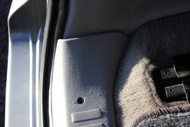

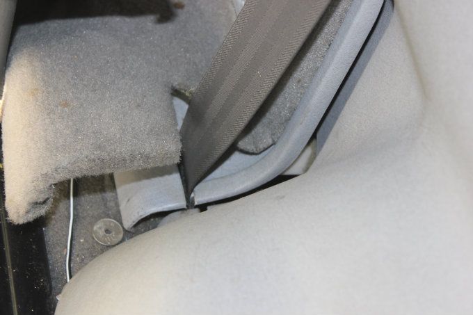

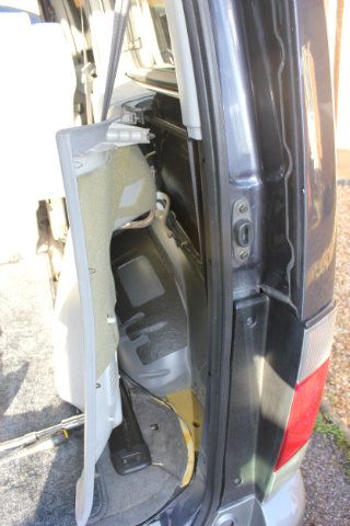

I have just removed my side panels for the first time with some trepidation even though many on this forum says its dead easy.
For rear panel remove seat belt bottom retaining nut (17mm socket)
Remove 2 screws holding rear panel and gently prise up, there a 2 lugs on mine that were already broken
I started from the right rear and gently pull from bottom out toward the centre (away from wall) moving fingers up and then applying upwards motion as well. I did use any tools to prise just fingers.
with a bit of luck we have some pickys (also my first attempt)
the mid right also needs to be loosened in order to totally remove the rear.

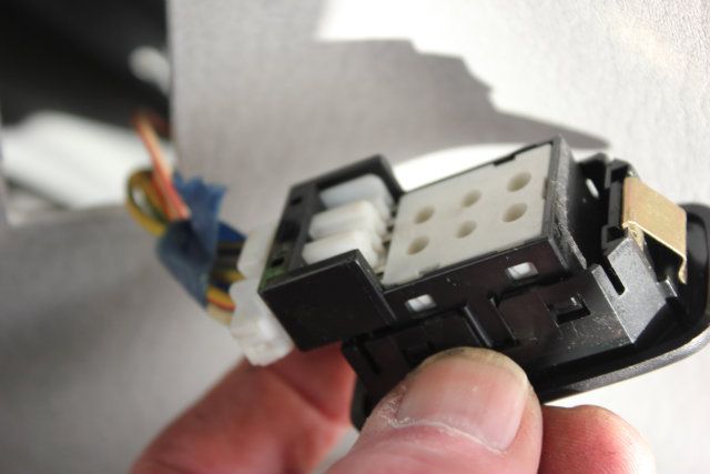

Don't forget the blind switch, push out from the inside to get easy acces to remove wiring plug
