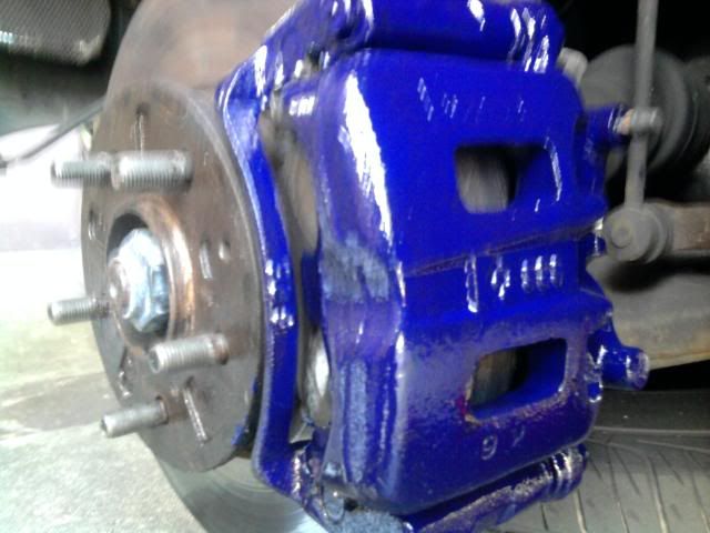

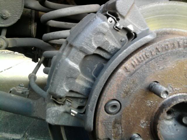

Luke and Debs wrote:just been reading about doing that. did u use paint or spray. how long did it take u
I used paint, not a spray, i had a batch made at a paint shop, the paint is specially formulated for calipers and they mixed it to the colour i needed.
Cost me £8 for a tin with enough to do the job another couple of times when needed.
It took me about 3 hours to clean and paint all the calipers, (i took my time) then you have to let the paint dry for a few hours.
Before painting.
After painting.
