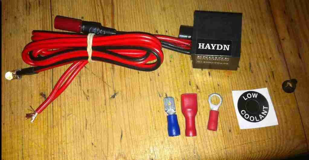

Re: Fitting a low coolent alarm HELP PLEASE
i have just looked at that kit on his website and mine and i seem to be missing half of it i.e i have the alarm part with the red wires ut not the other part with just black wires i think i may need to order a new kit boooooo dam ebay!
i will photo what i have maybe i can make up the rest with fresh cable instructions would still be good please if possible.
just make up the wire ...about 3 meters long with a male bullet on one end and a 5mm ring terminal on the other
you also need a led bezel and a sticker....also 3mm drill
Just buy a new kit....then send that one back and i will give a "fair" refund when I get back home.
I have a LED Bezel, I have a Sticker the only parts missing are the 3mm screw and that black cable with the crimped connector on which im sure i can make up i have a whole reel of cable for that job just need instructions on what goes where.
heres what i got:
Ok so all i need to do is make a cable up to go to the coolent tank connect solid red to the ignition live and the red/black to an earth and do all this while the battery disconnected and engines cool and mount my LED and sticker jobs a gooden yeah?
sorry if this was slightly tedious but better to ask than to go screw it up.
heres what i got:
