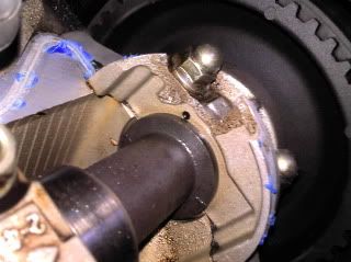

I succeeded in completing the near side =D> and started on the RH off side. removed OK and cleaned up and replaced the gasket. Proceeded to re-fit the cover but when I came to fitting the last nut I realised that the bolt was not perpendicular - a slight pressure on it and it became floppy :shock:
removed the cover again and found this: -
I have some photos that show the cover nuts were over tightened when the gasket was replaced last year and I suspect that was the root cause of this camshaft cap casting fracturing. You can see from the photos above that there is a fracture in the broken off piece and if you look carefully you can see that the face of the fracture on the main part is oiled across the majority of the face but relatively clean on the far left - which is where it was hanging on until I applied the final force that broke it off completely.
in this photo you can see that oil has been seeping out of this fracture over the nut holding the cap down - which is normally hidden under the front belt cover.
so it has been like that for some time.
woe is me :evil: :evil: :evil:
Anyway the reason for the post just now is the manual instructs you to remove and replace the cam shaft by undoing and tightening up the cap fixings in sequence a little at a time so
I need to remove this front cap and hopefully replace it - can i simply remove this one cap or should I slacken off all the caps to maintain an even stress on the shaft :?: :?:
