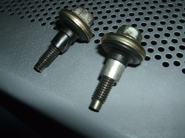

Service manual quotes 5.0-8.8Nm for the rocker cover bolts - my wrench doesn't go that low! Each bolt has a metal stand-off which should be snugged down but not compressed.
Don't do this... (see the one on the left)
Was there not a factsheet or a thread about these, too - some kits coming with different length stand-offs?

Driver+Passengers wrote:Service manual quotes 5.0-8.8Nm for the rocker cover bolts - my wrench doesn't go that low! Each bolt has a metal stand-off which should be snugged down but not compressed.
On a genuine Mazda head, there is a small recess for the shoulder (silvery bit) of the screw to locate in. On some aftermarket heads, the recess isn't there.
The silvery bit is basically a spacer.
On the aftermarket heads, you need to saw off a short length of the silvery bit with a junior hacksaw (it's quite soft material), otherwise you will get an oil leak around the cover.
