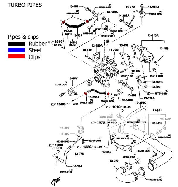

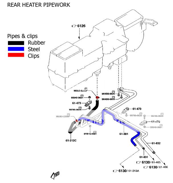

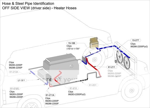

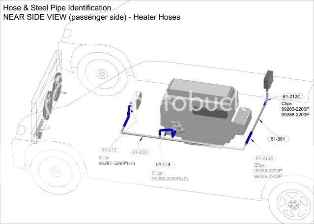

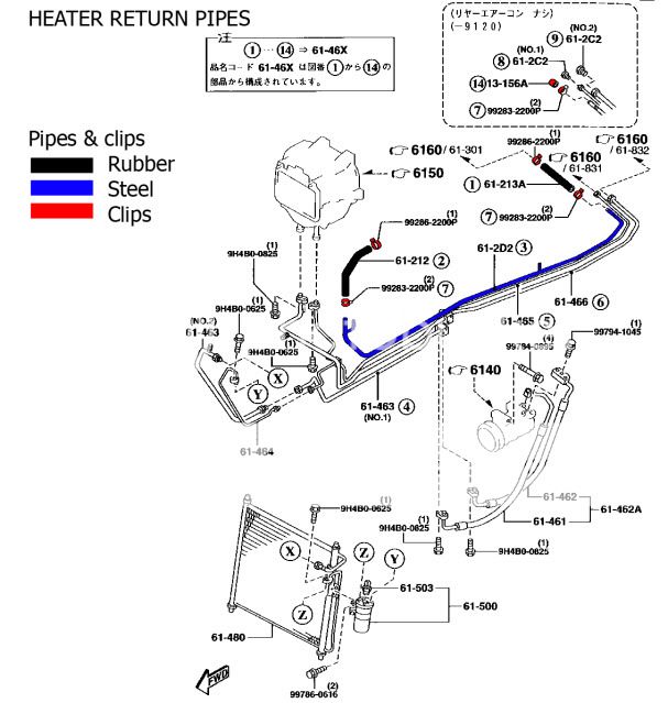

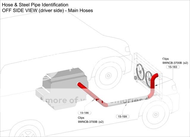

Two sets of diagrams that may help to identify which one you need.
Lushprojects set (coloured)
Schematic set
Schematic set
Steve
Re: Split coolant pipe- can't find new one!
That's a work of art (I can barely do a floor plan in Autocad)
Thank you for all your help. I think I have found it on one of the diagrams
