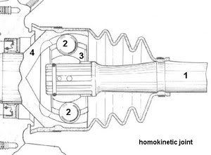

If you think about it if you have (on an old car) a king pin or on a new one a McPherson strut. There is nothing to limit the turn of the wheel apart from either an intentionally postioned 'stop' or the tyre hitting the wheel arch. This can be more than 90degrees. I have yet to see a UJ that can bend past 85 degrees and still transmit power At 90 degs it will lock up.
This happens to be off a Saab 900 but it is exactly what is on any front wheel drive or 4WD vehicle.
If you can turn that through 90 degrees I'll buy you a pint!
What we need is someone with the factory stated turning circles of both 2wd &4wd Bongos. Any offers anyone? Russion Contingent?
