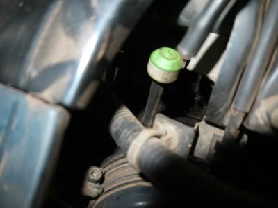

Also, any ideas what this green nipple might be coming off the inlet manifold just before the AFM?
It seems like it is in the right place to cause some problems.
Here, have a look at my nipple:

the little green thing is a one way valve, it can be repaired, it vents the vac from the egr exhaust gas recirc to the inlet manifold i think.
on the subect of the egr. with this still conected you are putting exhaust gasses into the inlet manifold to be reburned, this is adding to your heat, blank it off and it will give you more power as it will be burning fresh air not second hand air(if your emisions are ok for your yearly test etc.)

Ady beat me to it.. It is to do with the egr...?!!
part 13-995 valve check http://lushprojects.com/bongopartsmk2/c ... f02.html#4
