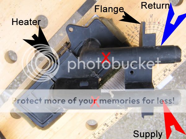

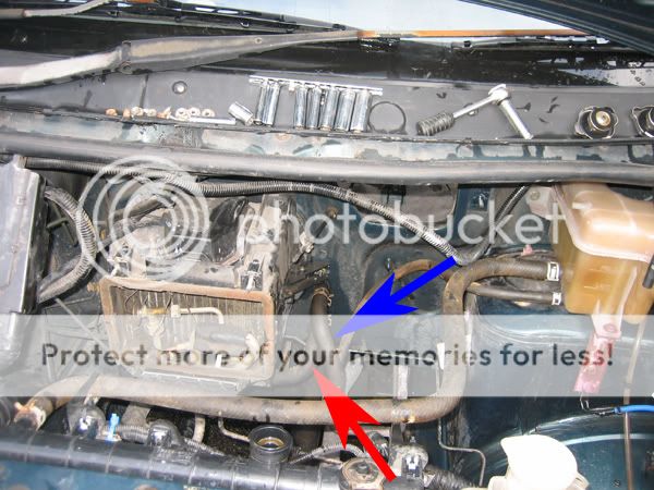

Pic.1 shows the heater supply (red) and return (blue) hoses as seen from under the bonnet. You will not see what’s shown in this pic unless you remove the fan, motor, and all the ducting, but this will give you some idea of the area to look. Don’t start taking things to bits just yet.
Pic.2 shows a side view of the heater stubs (red/blue). The heater is fixed to the bulkhead via a flange such that:
two pipe stubs shown to the RIGHT of the flange appear under the bonnet (these are what the hoses shown in the first pic are connected to)
and
the heater on the LEFT of the flange is in the cab in the passenger side footwell.
Note: Just noticed the pic is upside-down :oops: :lol: , but the principle is there.
The two ‘RED’ X’s shown on the pic are the pipes you should be able to see in the passenger footwell, and these should both be very hot.
Unfortunately, even if they are hot, you may still not be getting hot air blowing in the cab. If this is the case, then the heater is very likely to be blocked (common fault) and in need of flushing through.
