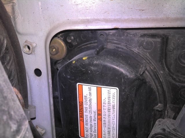

I need to change a headlight bulb on our Aero V6 (02)........
There are three bulbs on each side, two are standard and easy to access and change. The Third one, main beam, has a plate on the back .......
The guys at Halfords wouldn't touch it, and had not seen the likes of it.
Any suggestions?

High Intensity Discharge (HID) xenon or similar, arc lamps, with 25,000 volts/10 amps initiators. Don't meddle - take to a specialist.

In reality, I imagine there should be safety interlocks in the HID system, preventing you powering it up while the back cover is off - but I've never had them, and don't really know for sure. The "keep out" sign might just be health and safety gone mad, instead of just saying if you power it up, cover off, keep your hands away from it. On the other hand, it may be a kamikaze Mazda system, so better ask somebody at least - Yelloe Pages will surely identify somebody local to call.
Unless you've got the manual the warning notice refers to, I imagine you would have to take out the discharge tube to identify which one - Philips, who claim to have pioneered arc (HID) lamps for cars, apparently sell some mercury arc tubes, which can explode, releasing toxic mercury. On the other hand, there are plenty of HID upgrade kits available but how much you have to handle the innards to install them, isn't clear, so still better safe than sorry - ask around, unless you get better advice here.

Just make sure that the headlights are not switched on.if in doubt disconnect the main battery.

Treat HID light like airbags, switch lights and ignition off give it a couple of minutes and then swap bulbs, if unsure or worried any decent motor factor will do it for you.

FYI the HID is for the dipped beam rather than main beam which is a more traditional bulb :wink:
