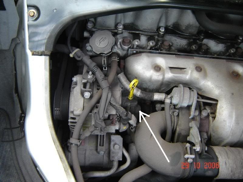

Hopefully these pics will help too

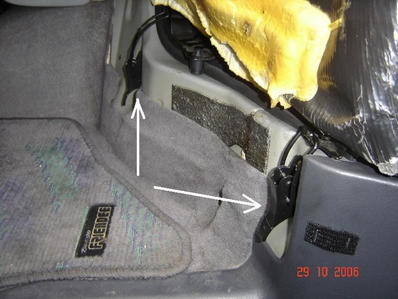

Lift the carpet at the front of the seat and undo the 2 clips (arrowed)

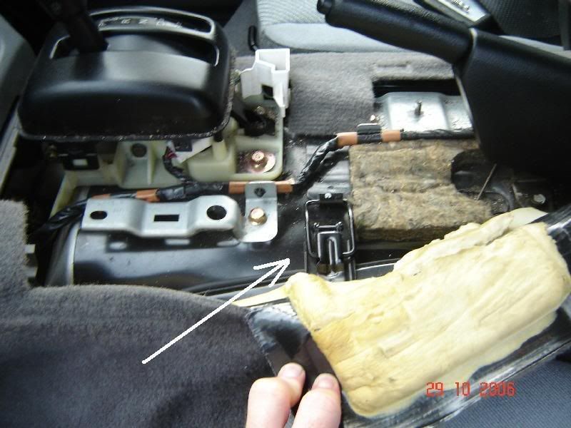

Undo the 3rd clip, which in under the carpet near the hand brake, the seat will now tilt back.
This will give you access to the engine bay, the same is done for the drivers side too.
I suggest if you are going to put oil in use a funnel with a tube.
