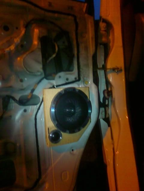

this is what i did.
you do need to really run these on an amp not the head unit.

PNC thats a great lill mod there but i don't have any plans to run an amp its just upgrading the 16 year old factory parts to get a decent sound. 8)
