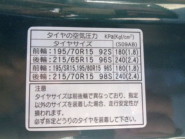

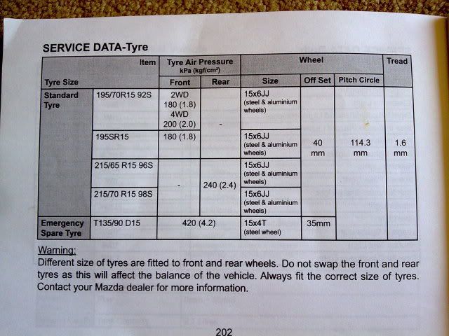

Ok, I'm not trying to scaremonger here, but that doesn't leave you much margin for loading the bongo (are you really going to drive around with it empty? - it's very easy to overload a vehicle of that size without realising it) & you're under the recomended tyre ratings in the handbook & on the drivers door plate
As you can see it says that 92S is ok for the front for a 195/70R15, but as soon as you move up to 195/80R15 the recommended rating is 96S.
For the rear you can see that the rating increases to 98S from 96S when you go from a 215/65 to a 215/70.
Personally, as you (& many of us) are fitting non standard wheel sizes, I would prefer to take the maximum value there & make sure all the tyres are above that, rather than the minimum, especially when fitting same size tyres all round.
