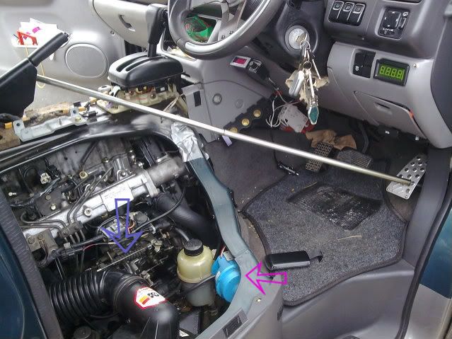

Post by missfixit70 » Thu Aug 18, 2011 2:14 pm
This (not very good) pic I found shows the servo/actuator (pink arrow) & the throttle control cable (blue arrow)

Post by dave_aber » Thu Aug 18, 2011 2:25 pm
Instead of linking the actuator to the handbrake lever and then that effing great pushrod, I'd have just linked the cable to the wee arm on the fuel pump....

Post by missfixit70 » Thu Aug 18, 2011 2:38 pm
dave_aber wrote:Instead of linking the actuator to the handbrake lever and then that effing great pushrod, I'd have just linked the cable to the wee arm on the fuel pump....
:lol:
(IGMC)
That's my dual control set up :wink: :lol: That's what I use when I'm bleeding the coolant to operate the throttle :wink:
Also doubles up as a seat prop in emergency situations
