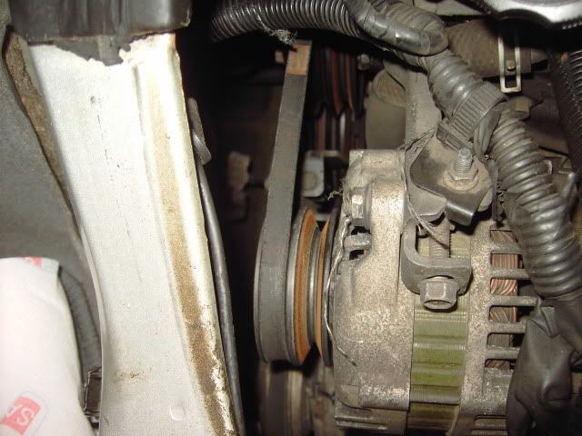

Doing pre Bakewell checks and found
a broken belt . The one nearest starter motor
What is it called?
what does it do?
and what is my next course of action?
Any help appreciated

There are 3 belts
alternator belts x2
and one for the air con

Thats one of the Alternator belts Baz. No immediate panic but its designed to run with two & will need replacing fairly sharpish. Best do them both at the same time.
About £14 each & a straightforward half hour to fit but - the BF Shop is out of stock at the mo.
Suggest Bongobits or Bell Hill.

Thanks for that.
Bakewell still on then order bits in the morning

On a serious note, it is probably best to replace both belts at the same time, as a used one will have worn differently, and might end up causing problems.
