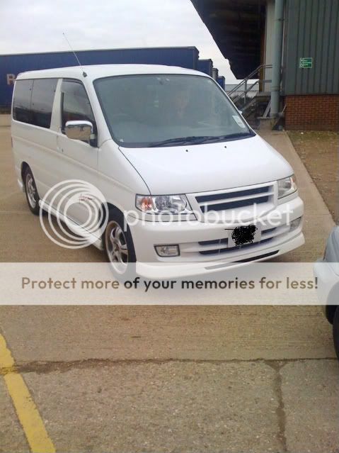

No, the soft-closure is working fine.....in fact, everything is working fine, except the C/L, which does operate the drivers door and tailgate!, it has reasonable mileage for the year (2001), and the interior is fine, no tears or burns...It really is just this issue with the locks, I just like everything working as it was intended to!!

It does look a corker! & it could in theory be possible to fit an after market remote locking system? (Though NOT tying in an after market solenoid with the existing passenger side loom, a prolonged pulse burns em out & the Bongo CL system has a constant voltage!)
:idea: Thinking off the top of my head though... Using a four door locking system, It may be possible to fit an after market remote locking system with a solenoid in the drivers door to activate the drivers door which in turn locks the tailgate... Now possibly the clever bit.. Pick up the wiring for the passenger side & sliding door by cutting the loom from the controller & patching to the new CL remote box wires... Then in the sliding door, fit a third solenoid from the locking loom from the pins in the door??
Total closure on remote?? Maybe?? :idea: :-k It's a challenge! :mrgreen:
