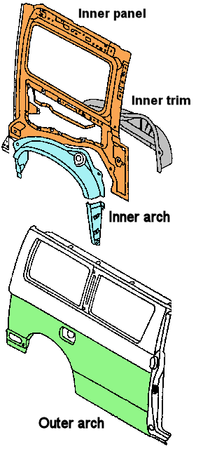

Interested in this as well as ours will need doing very soon, the Lush projects body diagram;
http://www.lushprojects.com/bongopartsm ... o=.html#26
suggests that 70-112/113 might be spot welded to the outer body skin as I can't see any sign of fixings ? Hence where the moisture gets trapped ?

Well just to add to the pricing info.we got a quote (written) yesterday to repair our two rear arches, the offside has just popped the paint for a couple of inches at the bottom and the nearside has rust stain markings in the same place just the lowest couple of inches again The quote from a firm in Sussex was for £570 inc materials and VAT, given the size of the problem he didn't think that it would be worth getting a pair of arches and would fabricate as needed going a couple of inches beyond the existing rusting areas but he did include in the cost one arch replacement to cover himself. Painting would cover the whole lower area on the rear quarter on both sides and the sliding door to ensure colour match.

From experience, cutting out and fabricating as needed is at best a temporary solution, as if your arches are rusting in 1 place, they'll be rusting alla long the seam. Said before, the bongo's have a seam of tape running over the arch which collects and hold the water allowing it to rust from the inside out, cut a bit of your outer panel away and you'll see it, about 15mm wide follows the curve of the arch and is sandwhiched between inner and outer arches, The only way to stop it is to cut out the arches,replace, seam seal and underseal inside and out to death, thinning some down to ensure full penetration.

321Away wrote:From experience, cutting out and fabricating as needed is at best a temporary solution, as if your arches are rusting in 1 place, they'll be rusting alla long the seam. Said before, the bongo's have a seam of tape running over the arch which collects and hold the water allowing it to rust from the inside out, cut a bit of your outer panel away and you'll see it, about 15mm wide follows the curve of the arch and is sandwiched between inner and outer arches, The only way to stop it is to cut out the arches,replace, seam seal and underseal inside and out to death, thinning some down to ensure full penetration.
Julian
Julian thanks for that and taking on-board what you say, partly why I thought I'd post what was described as the fix.
I take it that this "tape" sits between the green Outer arch and the Blue inner arch on the modified diagram below ? Is it some form of double sided body tape ? Or have I got the wrong end of the stick ?
