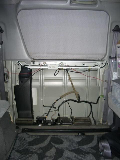

Hi everybody, can anyone tell me where the rear fan motor is located on my Ford Freda.

It's behind the side panel, behind the drivers seat, below where the rear aircon controls are. There is a recess on the edge of the floor in the same location as the step inside the sliding door on the other side. The covering panel just pops off if you give it a series of gentle pulls. Towards the bottom of this panel are 2 sets of vents: the front one is the outlet & the rear is the inlet which is in-line with the fan.
Here's a picture I took a while back - I have tried to highlight it in yellow:
