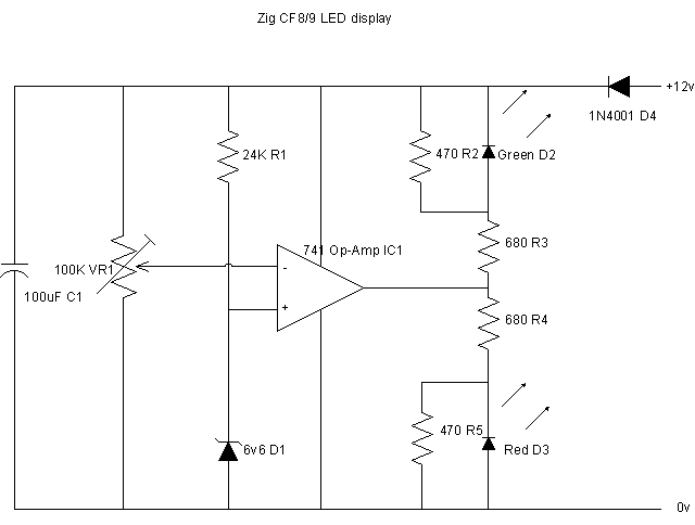

Green light on Zig Cf8 went out and didn't re-appear even with new battery - took it in for check - it is working fine but the Battery Status PCB Board needs replacing - Zig still making the Cf8 but don't stock these parts any more apparently. Does anyone know where I could find this part? Can't run to a new Zig at the moment and it is reassuring to know that the battery is ok - miss that green light!

Your very fortunate the circuit was found last week! So it should be fixable;
Layout;
If you can get the board out of the unit, I'm sure someone local could repair it with the info. above but if you have difficulty finding someone drop me a PM.

Thank you so much, I'll show the digrams and picture to Bongo mender and see what can be done. Yes I have a photo showing the little switch but how do I post it here?

The problem on the previous LED board was a couple of tracks blown to smithereens, so check the tracks on the back of the board carefully and make sure they all exist!
