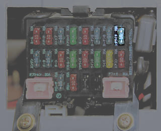

are there any spare fused positions on the fuse box near the right knee ????
i would like to run several gadgets and gizo,s where the electric supply is only "on" when the engine is running, and would like something not exceeding 10 amps available.
i don,t think the back of the ciggy lighter is man enough for my needs , although the fuse is rated at 10 amps !!!! the wiring looks too thin

Fuse box fact sheet makes it look as if there may be 2 unused sockets - no idea if they're live though

I think you will find that there are no connectors for the two spare positions on the fuse box, so you would have to fashion your own.

thanks for all the answers everybody, i,ve taken note and looked at every option, and it seems that numbers 7 and 14 fuses on the bonnet fuse box should be ok , as they are for ABS , which i don,t have, and provided i down rate the fuses, at the moment they are 30 and 60 amps , should great.
but (why is there always a but ???) what i want is a power suppy which is ONLY ON , when the engine is running, do numbers 7 and 14 meet this reguirement ???????

The ABS fuses are not switched by the ignition, they are permanently connected
The only fuses I can spot that are switched by the ignition are the FOG lamp fuse,15 Amp under the bonnet here
and the two 15 Amp fuses top row right under by the drivers knee

thats great G8dhe ,but what are the two fuses you mention there for normally ????? they must do something ????
Re: electric supplies to gadgets and gizmo,s
They cover lots of things! Oh and yes the third from right fuse as well;
The furthest right covers;
I suspect that so far you only have a Radio (5 Amps Max for a normal one), and the Door mirrors actually on the first circuit- assuming you have electrically driven mirrors!
There all on the ACC setting of the Ignition switch, so you might not actually have the engine running of course but the keys are in and turned to the first position.
