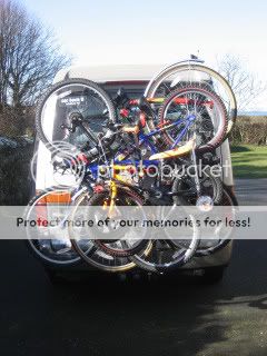

Just to tidy up this thread, here is a photo of my Bongo with five bikes loaded onto the Maxxraxx carrier. Highly recommended.

Re: towbar mounted bike rack
Post by mikeonb4c » Wed Mar 31, 2010 11:39 pm
lars wrote:Just to tidy up this thread, here is a photo of my Bongo with five bikes loaded onto the Maxxraxx carrier. Highly recommended.
Holy cr*p batman. That looks like you braked suddenly in front of the Tours de France :lol: :lol: :lol:
Re: Towbar mounted bike rack
Post by missfixit70 » Thu Apr 01, 2010 12:09 am
Or reversed into a bike shop :wink: Do you manage to get them all exactly the same way each time though? :lol: Hats off to you on that one =D> =D>
bongobaz
Posts: 910
Location: West Mids
Post by bongobaz » Thu Apr 01, 2010 12:13 am
Rubiks bike rack arrange by colour. :?
Post by lars » Thu Apr 01, 2010 11:23 pm
Yes, they always go on that way, give or take, heaviest/largest bike closest to Bongo putting the weight vertically on the towbar, lightest/smallest furthest out. As it's a single beam they all sit more or less at their point of balance. Surprisingly I no longer get tailgated. I wonder why?

Simon Jones
Posts: 9341
Post by Simon Jones » Fri Apr 02, 2010 11:40 am
Lars - you obviously use a trailer light board & number plate on that bike-fest :wink:

Post by lars » Fri Apr 02, 2010 10:46 pm
Obviously I do, otherwise how would I know which Bongo was mine in Tesco car park on a bank holiday weekend?
