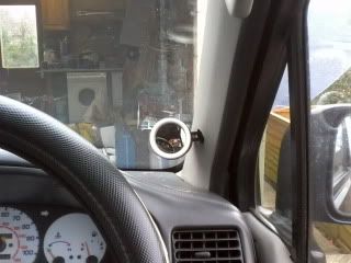

One o these helps me
with the old..
with the alternator...
