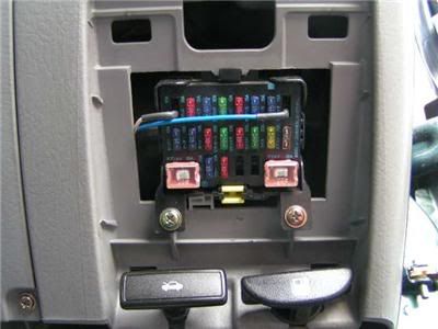

If its been wired up with a kit, there will be some extra wires patched into the fuse box by the drivers right knee, it'll look something like this

mister munkey wrote:If its been wired up with a kit, there will be some extra wires patched into the fuse box by the drivers right knee, it'll look something like this
If a kit has been patched into the rear of the fusebox, as is also possible (more likely?), it won't look like that.
