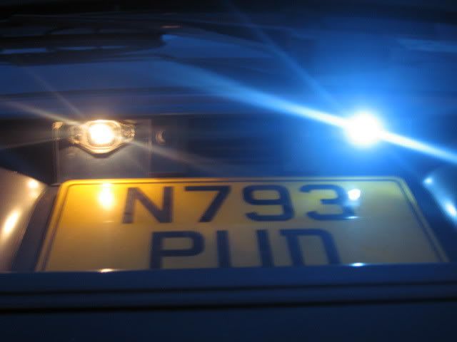

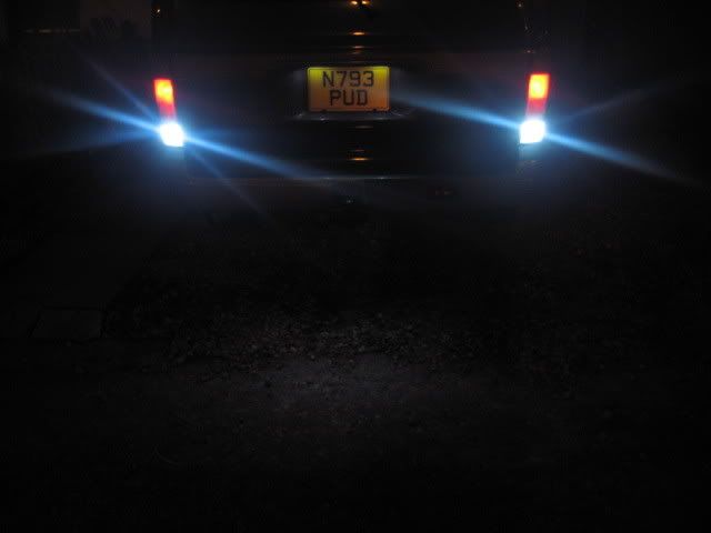

I have found my LED reverse lights are brighter than the original lamps, and have used w5w LED's for my numberplate lights. Did have them in the front side lights but was told they had to be removed for the MOT, so I'll use them for the front interior lights, as I have only one working at the moment.

Donald,
I've got the same W5W's as you in the numberplate lamps - definite help. The LED reverse bulbs I bought were nothing like as good as your photo though - do you have a link to the ones you bought?

Re: My first piece of maintenance - new tail-light bulb
I went for the CREE bulbs. They were quite small units, only 1cm across (compared to the 2cm ones commonly used in torches and mountainbike lamps). Pics from my phone, but I think they show that the lower power CREE's are a lot better.
