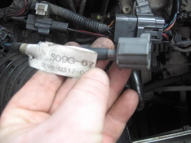

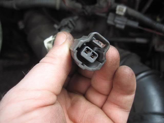

Worth checking the temp sensor which is on the head under drivers seat.
Heres a few photos....
This was causing my Brother-in-law's (oggy) radiator fans to run constantly from start up. The sensor had snapped off making it open circuit. So I would check that the sensor has been re-connected.... If it was disconnected for the job?

'brorabongo' hit it on the head and confirmed the temp gauge sender on the head as a possible cause which I said I was going to check in my comments last night after reading past postings. Thanks for the photos as they were really clear and helpful.
I had a look, all connections were in place with a new sender, so I thought .... no issues here, back to the drawing board! I decided to pull both connectors off and check pins, they were all in place and in good condition, so that's it then, depressed! :( Put it all back in place and made sure all connectors were fully pushed home hard,................ and tried it.
It started straight away, fans off and running as sweetly as it should at around 900rpm with no smoke.
Obviously a connector not fully pushed home.
Thanks again for the help. Really appreciated. =D>
