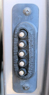

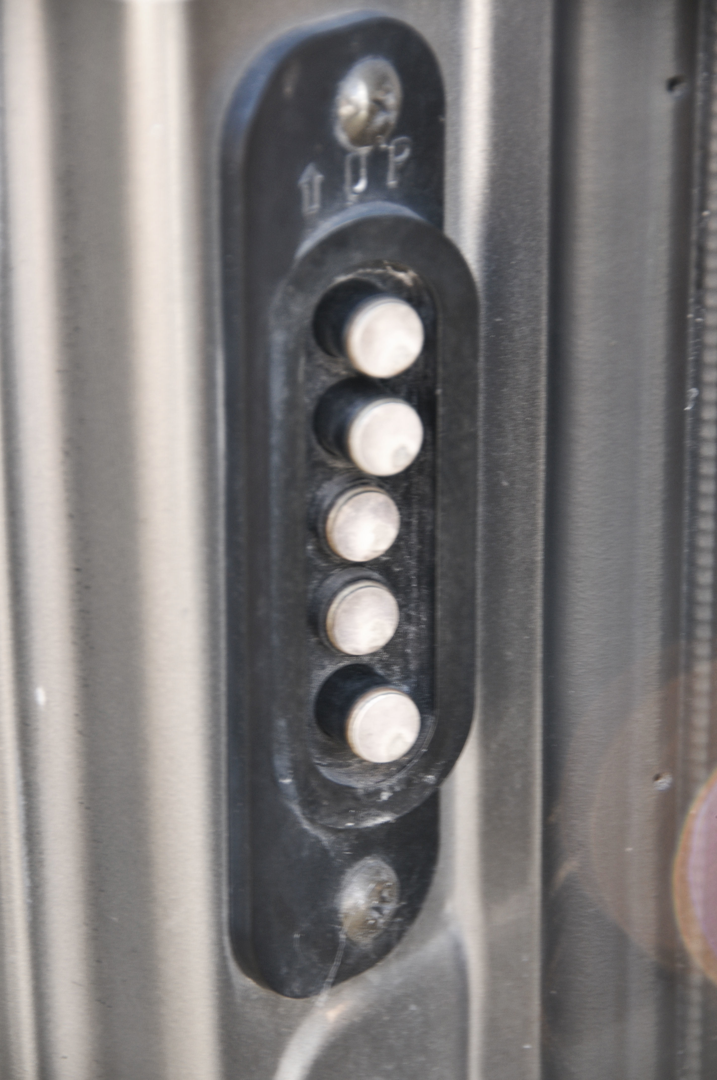

So I've had an auto electrician take a look at various problems, including this one, and he's not sure what's wrong with the side door.. some of the pins have plastic round them, some have the plastic stuck in, some of the pins are stuck in themselves... I think maybe my friend slammed the door too hard one time and now it's broken the console bit on both sides.. Can these be replaced?
Does anyone have photos of what the fully operational door sensor bits look like close up please?!
Dee

Only three of the pins are used, the other two aren't sprung at all and are meant to be recessed so that's not a problem :D
The foam bits do degrade over time, but I recall someone cutting up an old Mouse mat for the foam to replace them, a couple of layers were needed I recall. I'll take a photo later today of ours.
Posts: 10974
Re: Side door electrical mechanism not working.
Post by g8dhe » Thu Dec 10, 2009 12:38 pm
OK here are some photo's, click for fullscale image;

g8dhe wrote:OK here are some photo's, click for fullscale image;
Time to slip a new rubber on Geoff :shock: :oops: :lol: 8)

Glad to see the rubbers on your sliding door are looking as manky and perished as mine.
This post has saved me a lot of work (thanks Kitegirl) as I was about to photograph mine (it is sunny today), put up a piccy and ask if anything could be done about the perished rubbers.
All questions answered here, thanks Mike. Won't be chopping up my new Bongo mousemat though. Need to remember where my old one has been "filed" (it wasn't in the bin, where it should have gone - probably just as well :lol: )
Alison
Posts: 10974
Post by g8dhe » Thu Dec 10, 2009 3:35 pm
Well I must admit when I saw the idea of using a Mouse mat I took an old spare one down to make some measurements, but then realised that despite the looks of the foam, its not actually cracked and is still very flexible. The appearance is down, I think, to the flexibility of the foam so its wrinkled but not actually broken anywhere, and certainly there hasn't been any moisture getting into the inner section that I have noticed. So give it a good squeeze and squash before deciding on a new rubber ... oh err ... :oops:
