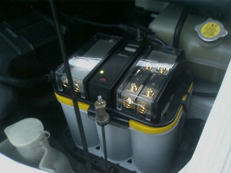

i seem to be having a problem with my second battery i have a split charger fitted which has been working well and i'm even sure its at fault now. the stereo runs of the second battery as does the blinds and internal lights. i noticed the other day that the rear internal strip light was dim now the stereo loses all its memory when i start the van, it normally keeps playing and does not lose its memory can anyone help me with this one. also i have a audio decoder running direct from the battery and not through the split charger system and that loses its memory too. i've put a meter across the second battery and it turn out about 11.80v the main battery puts out about 12.8v i've not done to many long runs in the last few weeks but i have been using the van sat up e.g lights etc while i've been working on it. the blinds, stereo etc are still working parked up so are the lights it just the memory side of it i can't get my head round.

i have the split charger that everyone recommends can't remember the name right now i'm sure it starts with a w. it started playing up last night in as much as the rear light but the stereo started today. i have a 5.1 decoder that takes its power from the direct from the battery.
if you look at the pic below it will make sense how i'm picking up the second battery for power without the split charger.
http://i86.photobucket.com/albums/k96/p ... GE_964.jpg

It appears that you are using some of the the leisure battery to power your stereo and some connections via the ignition.You have to have a permanent live(with inline fuse) and negative to the memory side of your system to maintain it.When you turn off the ign,the memory will fade because you have disconnected the power to the system.Try connecting all the live wires(with the correct inline fuses) and negs directly to the L/B.The only thing is,you will have to remember to turn the system off when you leave the motor,or the battery will drain after a period of time.There should be a wire that is dedicated on the system to perform the function of keeping the memory intact.
The other thing is to meter your fuse box to find the wire that goes positive when the ign is turned off,this will act as the positive feed to maintain the memory.As the post above,the split charger is nothing to do with any wiring from the L/B.Hope this helps you,regards.
