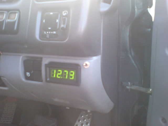

Post by missfixit70 » Wed Aug 12, 2009 3:35 am
I got one like this http://cgi.ebay.co.uk/20V-DC-ON-OFF-BLU ... 286.c0.m14 rigged it with a small on-off-on toggle switch so I can check LB & Starter battery. Mounted it in the small storage cubby above the fuse box, had to trim the corners to make it an interference fit, but it works & looks great.
