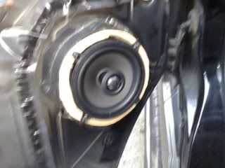

Okay - the speakers I've got don't fit. :cry: The Mazda originals seem to be larger than 5.25" to the outside diameter - more like 6". 5.25" (13cm) replacements will leave a gap around the mount. The Mazda ones are also 3 screw fittings, not the standard 4.
The JVC ones I've got are also too deep - the tweeter bits stick out too far and will interfere with the grill. So a complete waste of time and money!
Does anybody have any tips for saving my purchase? My wife is already annoyed with me for spending £30, so I could do with saving a bit of face if nothing else :oops:

hi dom-e would it be possible for tou to make a spacer ring out of mdf to pack your'e speaker out and away from the door skin. then you could remove the origanal speaker grill on the door card and replacewith you're new ones.i had to make mdf rings to pack mine out,like this

Post by dom_e » Sun Mar 29, 2009 1:04 pm
Thanks Tay. I was hoping to avoid lots of DIY (time is precious with a baby), but I think it's going to be the only way. I'll have a potch around when I've got some more time. =D>

tay wrote:hi dom-e would it be possible for tou to make a spacer ring out of mdf to pack your'e speaker out and away from the door skin. then you could remove the origanal speaker grill on the door card and replacewith you're new ones.i had to make mdf rings to pack mine out,like this
Do you find the gap between the inner door skin and window when its down very small?? mine in around 1.5inches form it and really reduces the size of soeakers that can be fitted. i have seen posts on here of 6x9's being fitted but i cant see how its done even with a packing behind it as surely they would still stop the window from going all the way down? :? :?
