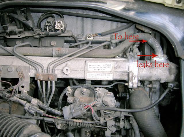

finally found out how to add pics hehe, this is the pipe that seems to get a little wet. The cylinder head gets wet behind the pump and seems to travel backwards, covering everything. Will post some more when I get a chance. Have since bought some blanking plates, going to fit them this weekend, watch this space
Re: leaky freda
Post by missfixit70 » Fri Mar 20, 2009 9:53 pm
You just need to figure out how to make it bigger so we can see it now :wink:
That is the EGR pipe going from the turbo to the egr valve & on to the point you've arrowed which is where it meets the inlet manifold. Nothing to worry about, get the blanking plates fitted.
