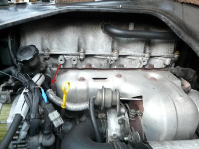

I think that is the wrong place you are looking...that looks like the end of a bolt to me.
This is where mine is..."I think"
Dandy....Help.
Dandy....Help.

don't seem able to orentate that 2nd photo in the first post...or have you removed the heat shield ??

Mine was broken where you pointed out on yours Haydn.

Thats not the same bolt as in Mighty_Quin's photi is it ?? so perhaps his garage are not mistaken....we need a photo of his No 1 stud

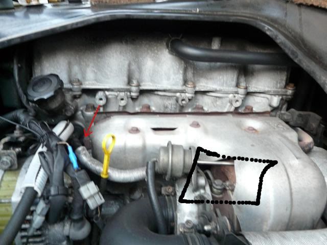

My microscope and eagle eye suspects the picture is of this area
not an inlet manifold stud

You're right weston - still, it looks like a sheared bolt/stud on the exhaust side of the turbo

Thats not normal if thats the case.

Thanks for the rapid replies. Westonwarrior is exactly right with the location of my picture. So it looks like I might well have a sheared bolt on the ' exhaust side of the turbo' (thanks dandy) as well as this...
