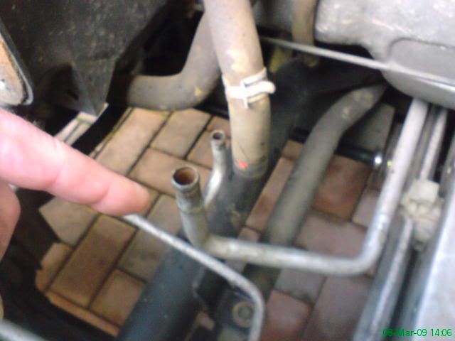

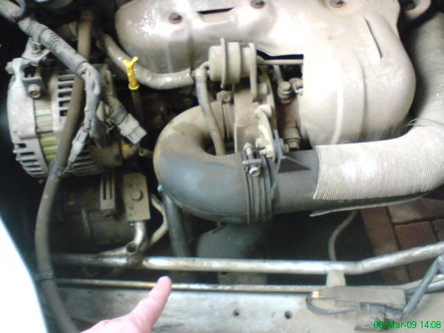

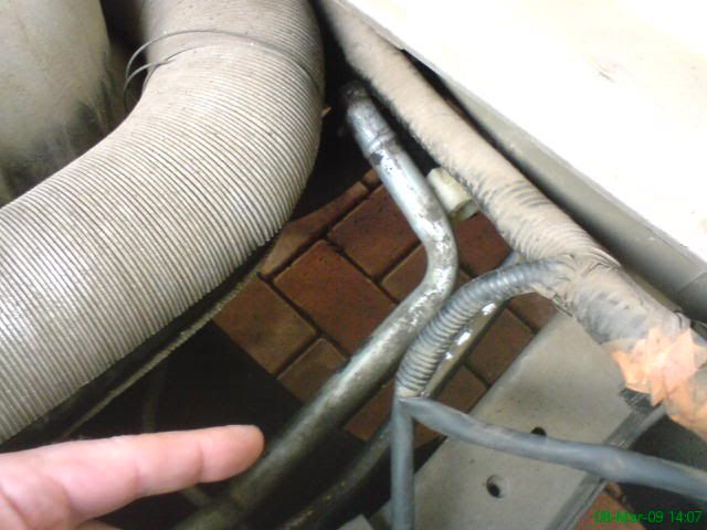

This is the pipe
This is the metal pipe where the 'T' piece that is leaking comes off.
This is the front end. The 2 uprights connect to the heater pipe and the small pipe which goes to the header tank
This is the back end of the pipe.
I hope this makes things clearer. I still need to know how to get this pipe out from the van so i can get the 'T' piece brazed
