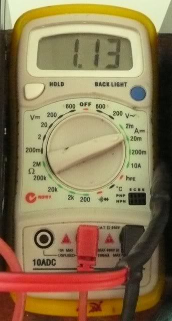

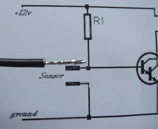

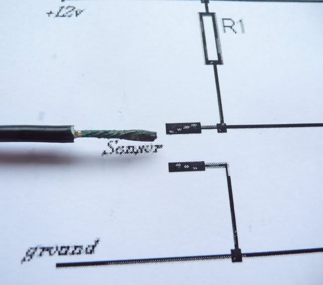

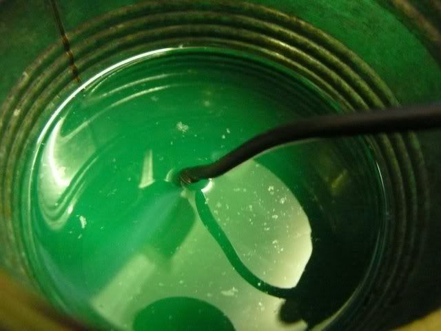

Our Top Man in the EnginSaver research labortories over in Oz has been taking some interest in this topic and has provided the following info in a effort to save some Bongo Rads. Poor chap has been working whilst we have all been asleep...
Photo 1 is a peice of wire coated with the same solder as is used in radiators.
Photo 2 is the same peice of wire after having been used as a probe for five hours with a 10k resistor at 12.3 volts as in the circuit in the post
Photo 3 speaks for itself
Photo 4 shows the coolant..the bits are bits of probe
On test it actually supplied 1.13 milliamps
This rapidly decreases as the solder is damaged and the resistance rises as the probe coats.
This will of course cause the alarm to go off.
The inside of a bongo coolant tank is quite conductive, so using this device as a hi-level alarm is not a good idea either.
That is a lot of electricity
