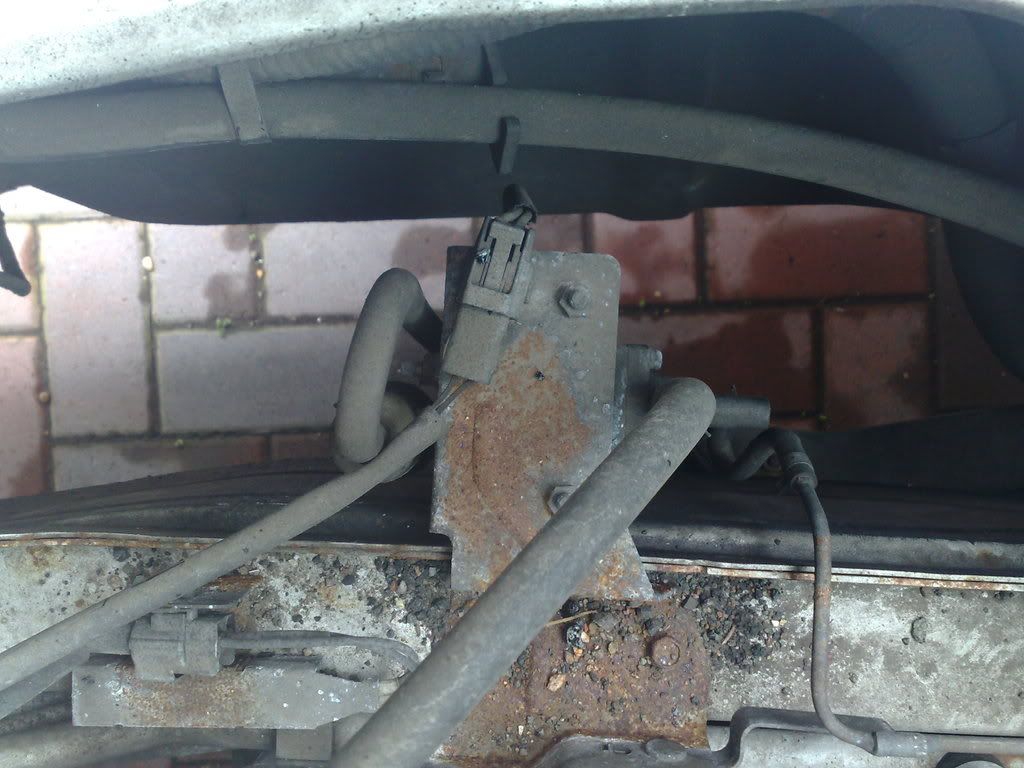

when I lift my passenger seat to look at where his is fitted(if you look at the photo titled mounting plate), I have this attached to one side
http://i276.photobucket.com/albums/kk28 ... ngo002.jpg
Any suggestions as to what this is? Cos it's gonna make the Eberspacher a tight fit!

by the looks of things it looks like your bongo at some time of its life had a wabasto heater fitted
you've been bongod

Seriously though, we do have a Webasto Airtop 2000, and the connections to it don't look anything like your photo.
On another note, the outlet comes out in the middle of the van, which I would say is better if you can organise it, than the door well.

Hi its all to do with your winter pack you will have an exhaust flap fitted I had this on mine and tossed all the pipes and vacume unit you show in the picture so I could fit my webasto airtronic 2000 so just do the same the best thing to do is the main supply pipe to it is cut it then bloke it of but make sure the exhaust valve heater switch at the o/s of the dash is in the off position first.
Gary

Hi all i have the same thing as Morag under my passenger seat do we need it or can it be taken out.

I'm looking to take it out Oggie, I'm provisionally booked in to get a full system fitted at Longlife in Leeds and I think they're going to remove all the bits that are worked by the 'thingy' so I should be able to disconnect it all then [-o< I'll let you know.
