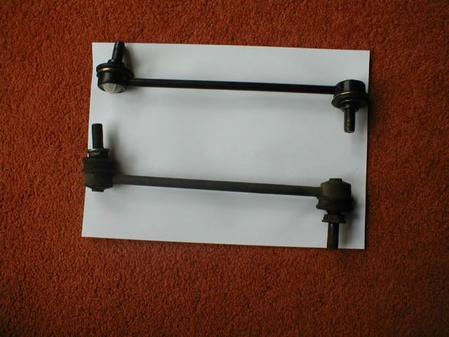

Mike - as far as i can tell its not a ball and socket and I have a faint memory(theyre all faint now) of someone posting that they are tapered. Photo below of old and new may help. There is a boot of sorts covering the actual joint. With the old I can wiggle the bolt around but no movement on the new. What I found useful about having the van on the jack and the wishbone on the axle stand was that I could move the wishbone up and down a little so as to adjust the distance between the 2 bolt holes to match the link length. In different circumstances I assume one would move the antiroll bar to match up. As you can tell I am no mechanic but learned long ago that 'time spent on reconnaisance is seldom wasted'.

Why does Photobucket show this image as 160x120 pixels and then posts it as higher resolution?
Ron
Re: HELP: Which front droplinks to buy
Post by mikeonb4c » Thu May 01, 2008 5:32 pm
ronhud wrote:Image
Ron
Blimey - the Vectra one looks indistinguishable from the Bongo one (unless of course it had already had a Vectra one put on during an earlier replacement......only 2 years ago..... :shock: )
