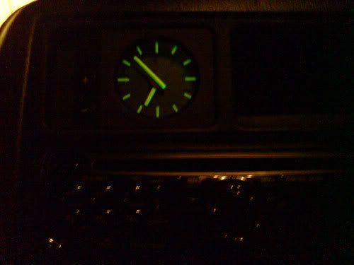

Just pull the bottom forwards, it should be a friction fit. If not ..remove clock and superglue a couple of small "stops" What colour does it light up?? The frame looks a little bent, you need to file off a bit of the locating lugs to correct that.

thanks haydn, ill have a lookie in the daylight tomorrow and see if i can get it in a bit better.
lights up orange at the moment which is ok as the cd player is red, red or green would probably be better. do you know a part umber or bulb type for it if i decide to change him?

Post by meek.tv » Tue Oct 30, 2007 12:16 pm
a bit of shaving down with a craft knife and its in a lot better.
biggest improvement is i realised the iso connector was fouling something behind the cd player so it wasn't goin in all the way, bit of a tweak and a little brute force and its all sitting much nicer. thanks peops 8)

Post by meek.tv » Mon Nov 05, 2007 10:10 am
now glowing green. cheers haydn :D
