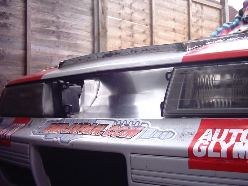

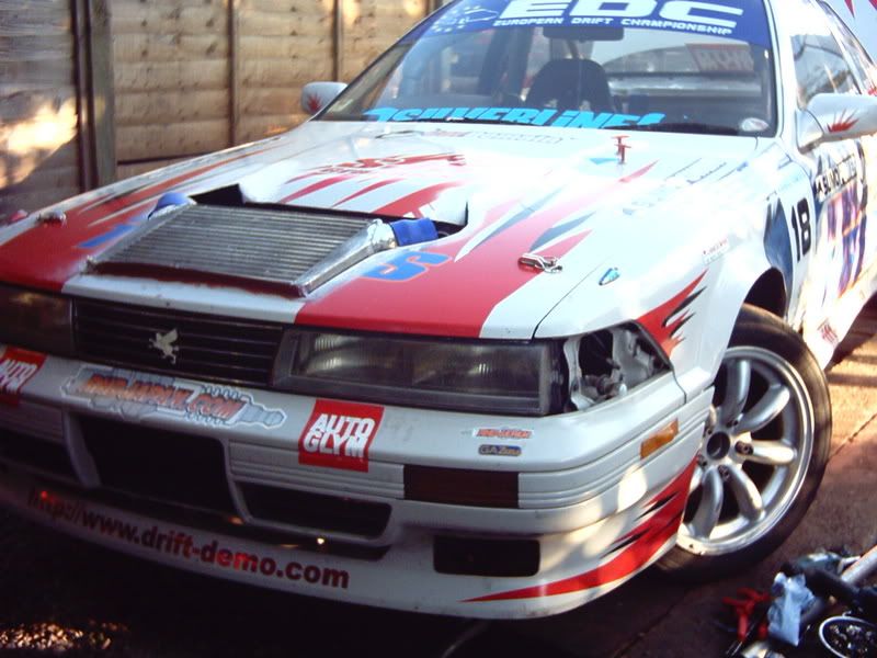

Plenty of aftermarket ones about for not a lot of cash check ebay out for bargains. All you need to do is some basic measurements & then faff about for a day doing the pumbing. For an outlay of no more than £200 it'd be worth it imho.
Here's mine though it's not on a Bongo ;) It's called a V mount set up, ducted air goes through the grill & uses the negative pressure over the bonnet to draw the air through. At about 70mph my intercooler works out at about 75-80% efficiency when measuring in & out temps, which is pretty good.
Good enough for 440bhp at the wheels ;)
Some pics during work in progress.........
Posts: 10637
Location: Ince Lancs
Post by bigdaddycain » Mon Nov 05, 2007 6:25 pm
Nice motor cap'n :wink: But , surely that I/C should be longitudinally mounted for better airflow when drifting? :lol: :lol: :lol:
